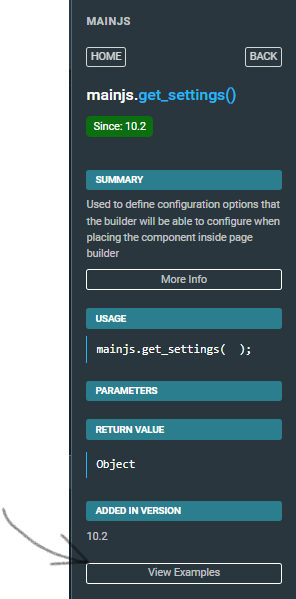

Are these what you mean ? Click View examples and some are listed.
