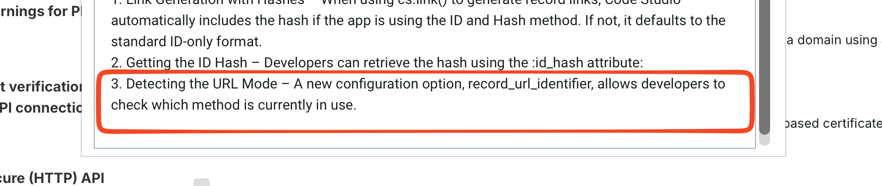

How exactly do I find this in CS ?
image1750×370 69.4 KB
isn’t in cs.context() and isn’t a cs.config(xxxxx) item either ?

You might actually be looking for the cs.url_params() option.
So if you url uses a hash that would be the id_hash option, the id might be context_record_id or ‘id’ depending on the URL content. The record_url_identifier may be another option from the url.

I think it was intended to be added to cs.config() but doesn’t look like it was. I’ll check and raise a bug for it.
It could be that this is new new code studio functionality - possibly newer than the build studio original functionality and therefore I might not have a recent enough version ….
That being said I’m on 2025.2
Turns out it is available…
cs.config('RECORD_IDENTIFIER_IN_URLS');
which returns either “context_record_id” or “id_and_hash“.
Documentation will be updated to make this clear.
