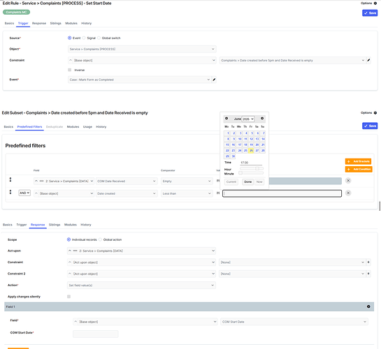

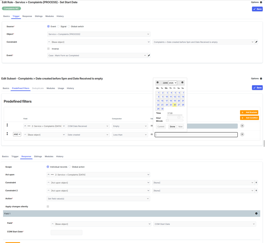

When the form is completed:
  • If the created date/time is after 5pm and Date Received is empty, set Start Date to the next working day
  • If the created date/time is before 5pm and on a working day and Date Received is empty, set Start Date to today
  • If the created date/time is before 5pm and not on a working day and Date Received is empty, set Start Date to the next working day
  • If Date Received is not empty, set Start Date to Date Received
I suspect that the way I am trying to implement this just won#t work. I’m unsure how to handle the time (5pm cutoff) and working day logic within the rules. I attempted to create a rule to set the Start Date when the created date/time is before 5pm on a working day, but I’m unable to specify the required time and working day conditions.

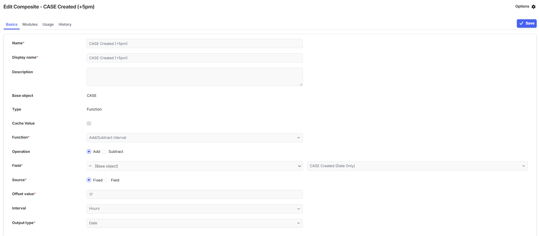

I’ve done similar things in the past and I’ve created composite to calculate the 5pm Date Value…and use this value in the subset.

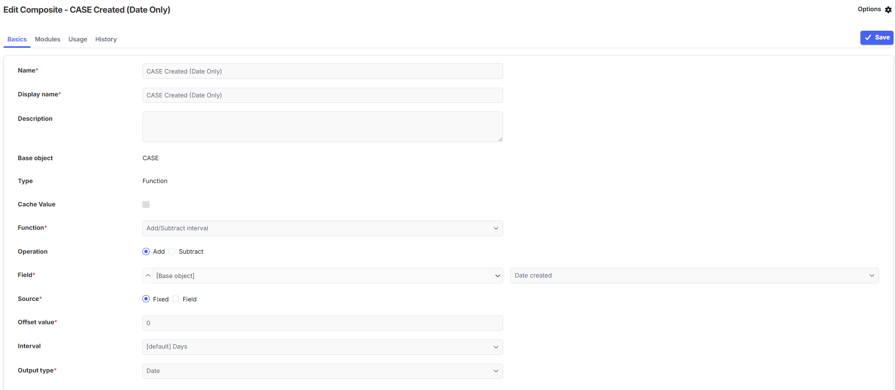

You can add one composite to get just the date for a field – e.g. Date Created
And then another composite to use that to add 17 hours to 1st composite
You can then use this composite in your subset…
There is likely a better way, but this is what I’ve done in the past.

In your scenario you want the Start Date field to be populated when the form is submitted (or when the record is created). That is a write back operation, you need a rule, event or workflow that sets the field’s value in the database. A composite can’t do that it can only display a derived value so you will need something to store that value.
You could create a composite that shows what the Start Date would be based on the logic you described, but the actual field would still need to be set by a rule so that the value is persisted and can be used by other parts of the system (e.g., due‑date calculations, reporting, notifications) or if you add both fields to the page, you could hide one and copy the derived value and save on submit to use later.
