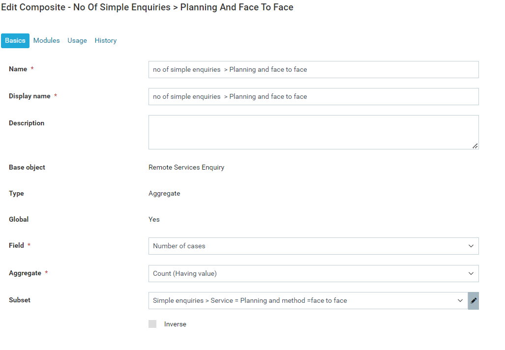

hi @ali.bandali
Thanks a lot for the instructions. Yes, what I want is for a count. I have created the composite subset. But it still doesn’t display the correct value
I assume its because this needs to be triggered using an event an a rule?
I’ve created a form submission event and a rule. But not sure whether its correct.
