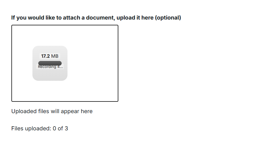

Has anyone else experienced the file uploader (7) getting stuck? It seems to happen with any larger attachments - see my example of a 17.2 mb upload getting stuck at what appears to be 100% upload progress…
I can see Netcall has added to the documents area of the system but on the form it never gets removed from the dropzone and added as a record/item on the list underneath. (So if uploader was a requirement on the page customer wouldn’t be able to continue, although if I were to press a back button and then continue again to reload the page with the uploader on the doc that gets stuck is then added to the list underneath).

I’ve just tried a 16mb file and it got stuck at 100% upload bar, but refreshing the browser window worked to move it out of dropzone box to list so if I’m short on a fix I might just add in a line of text to let customers know that’s a possible work around…

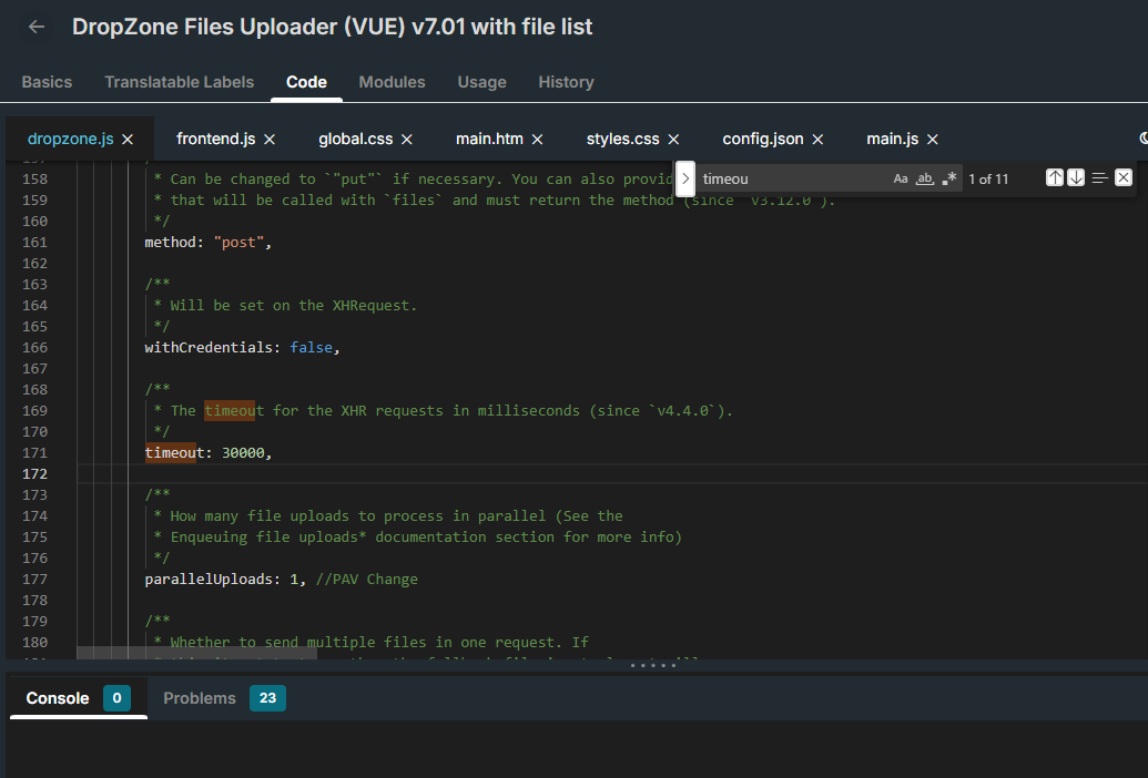

It sounds to me like it might be timing out? At least on the front end, if it’s actually completing in the background. Does your listing widget refresh on E1 event (check the advanced setting)?
Also, what browser do you use? I can see that there are lines in the code relating to timeout in certain browsers, so I wonder if different browsers behave differently. Testing your link in Chrome, I can upload 10MB files without issue.
Final question, how long does the upload take before getting ‘stuck’? If it’s always running to about 30 seconds or so (and the same every time) then the timeout setting in the code for the dropzone widget probably needs amended.
Hi Scott, thanks for the reply. I think the widget has an inbuilt remove from dropzone and add to underneath list setting as the list is also part of the widget so there shouldn’t be the need for the event refresh but I did try introducing an E1 action link and refresh on the widget but that didn’t work to nudge the move from dropzone to list bit either. I’ve also tried doubling the timeout to 60000 but that didn’t work either…
I’m not sure what to try next… and I’ve left the 16 mb doc on 100% for the progress bar for 15 mins before giving up- and same stuck result on both chrome and edge so I don’t think it’s the browser…
60000 milliseconds is still only 60 seconds, so it’s not impossible that it’s still a timeout, but it’s less likely.

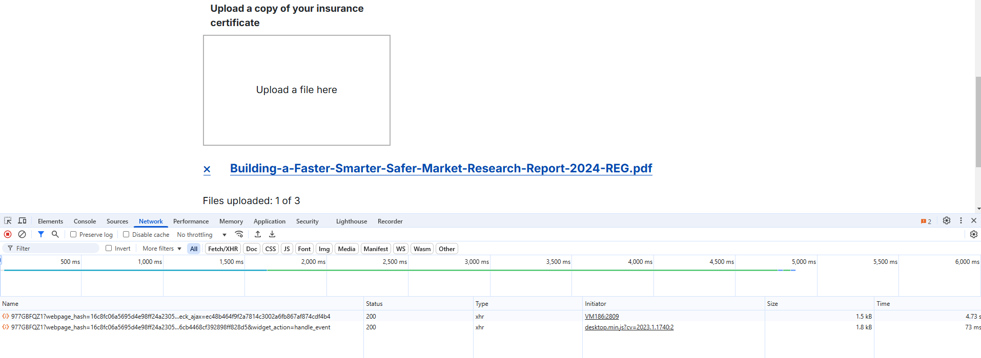

Can you open the browser console and see if there’s any errors on the Network tab?
In Chrome, it’s F12 to open the developer tools panel.

Thanks so much Scott, I’d misread amount of zeros hence just doubling - I’ve just tried upping to 300000 and it’s working again for large files.
