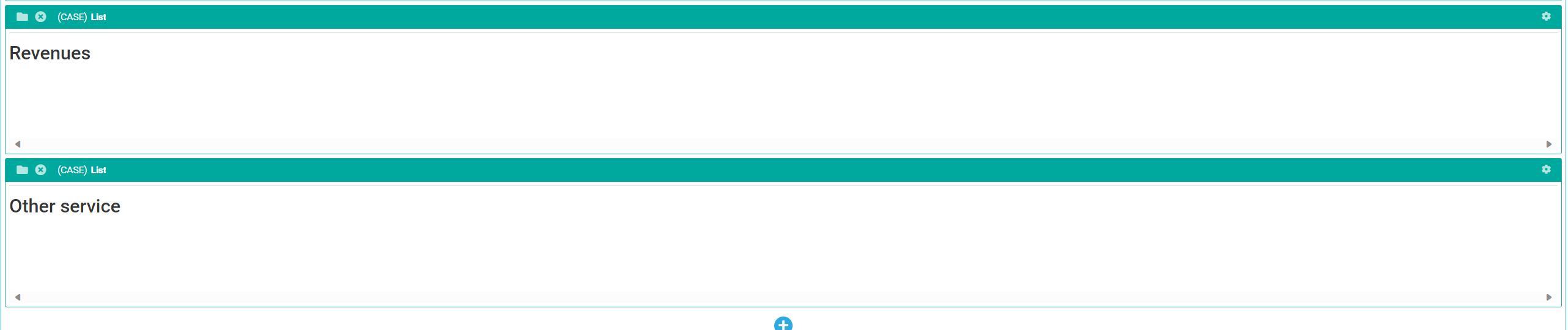

With regards to filtering lists you should use subsets. If you wanted to have a page where multiple service areas can drop in and see a list of their Cases, you could put multiple case lists on a page:
You would then subset the revenues list to only show revenues processes, then add a Visibility Subset or Visibility Privilege as well to target the users you want to see it. Then it should show based on the logged in used on the page.

Yes, as Dan says, having separate widgets makes it easy to show/hide whole lists of cases based upon a privilege of the logged in user.
But there is no way to use a privilege to select which rows within the listing are included.
Perhaps you are using a parent object with dynamic relationships to various case-type objects to get them all in one listing? If so, then a ‘read’ privileges on each object would mean users would be prevented from reading data from appropriate case attribute fields… But I think the row would still be there in the listing.
