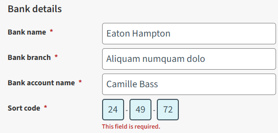

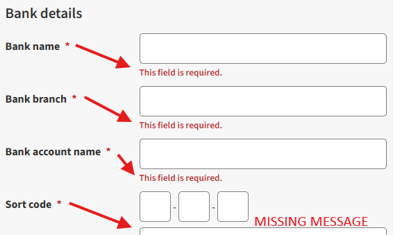

Unfortunately it isnt applying the Required field onto the presenter correctly in various ways.
Issue 1: even though field is required, when submitting no warning message is shown
Issue 2: when the field is filled in and submitted it shows as required now??
This logic seems back to front, but looking at presenter code I can’t see any references to Required fields.
