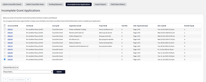

I have built a UI to display active cases that are incomplete, and added Bulk Actions and selected the two I need.
  1. Send Email Reminder, this is working.
  2. Abandon Case is not working, e.g. the Case is still Active.

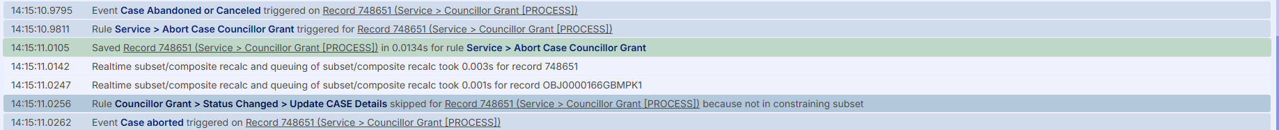

When I trigger the Case Abandoned or Cancelled event on COG/92, I get this in monitor studio.
And If I try and Abandon the same case COG/92 again….I get this as the process has been Abandoned (but not the case still)

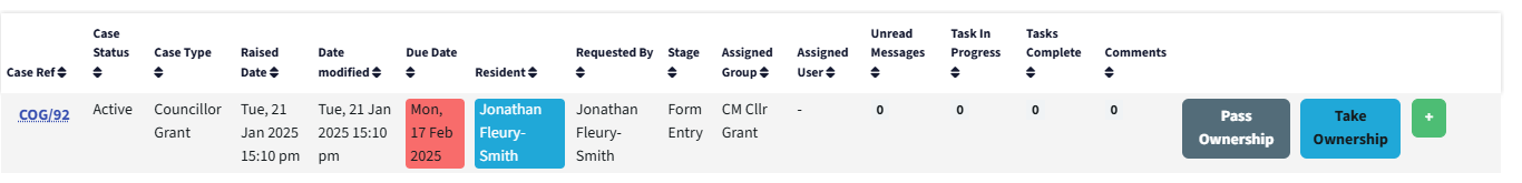

And the case still shows as Active on Central and Grants host.
I don’t understand why this isn’t working?

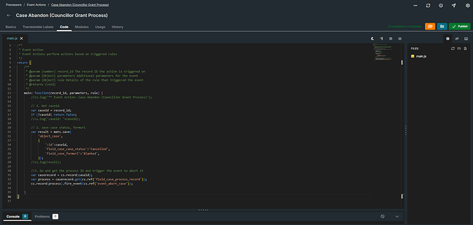

Well, I’ve had to break out code studio and write an event action to Abandon the case, this works like a charm now, it basically updates the CASE : Case Status=’Cancelled’ and FormURL=’Blank’, and then fires the Case Abandoned or Cancelled event.
