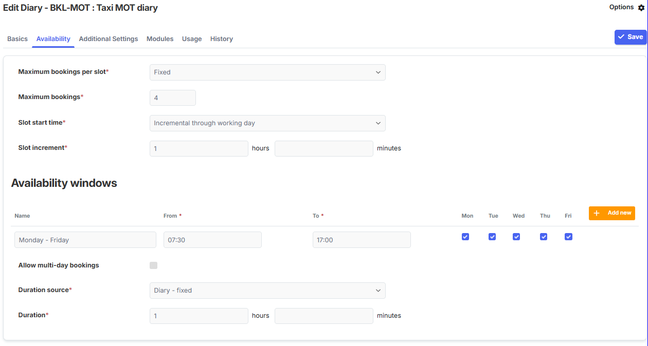

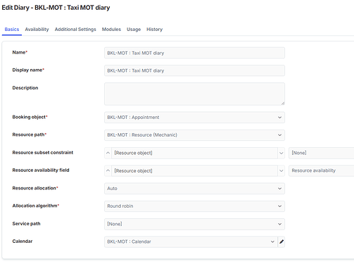

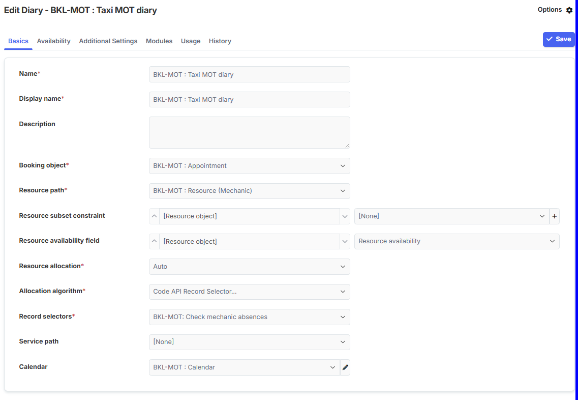

I’m working with the Booking Object using a Diary + calendar setup, specifically using the Start field (booking time picker / timestamp field) with a fixed appointment duration of 1 hour.

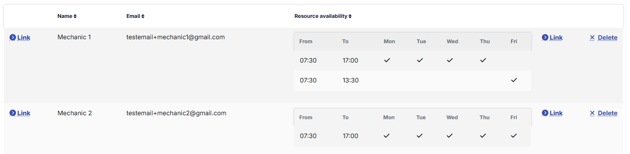

I also have a Resource object (Mechanics), where I’m using the resource availability field to define working hours (e.g. Monday–Friday availability) of each mechanic.
I’m trying to understand the best (supported) way to customise the date selection behaviour, and would appreciate any guidance regarding the below:
I want to restrict the date range that users can select in the Start field, for example:
  1. Restrict booking dates to a fixed window (e.g. today + 30 days only)
  2. Prevent users from selecting dates outside this range
  3. Ensure the existing Diary-based slot generation logic remains unchanged
  4. Respect resource availability rules (Mon–Fri working hours per mechanic) - which it does because of the resource availability field, but unable to control this with absences integrated
  5. Support resource absence logic (e.g. holidays / leave), so mechanics are not assigned bookings on unavailable dates
  6. Ensure bookings are never allocated to unavailable resources automatically

I have attempted to use a Resource subset constraint, however this appears to only support static filtering (e.g. user role = Admin), and does not support time-based logic such as:

Example (resource availability set on mechanic):

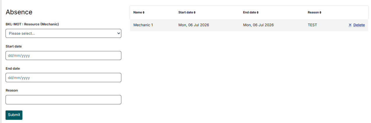

Example (resource absence):

I think I have found the solution to this. It would be to use resource availability to define each mechanic’s normal working hours + a record selector.
For example:
Mechanic Availability
  • Object: BKL-MOT Resource (Mechanic)
  • Availability: Monday–Friday, 08:00–17:00
Then create a 1-to-many relationship between BKL-MOT Resource (Mechanic) and BKL-MOT Resource Absence. This will allow each mechanic resource to have multiple absence records stored against them.
Mechanic Absence
  • Object: BKL-MOT : Resource Absence
  • Absence Start Date: 10 June 2026
  • Absence End Date: 10 June 2026

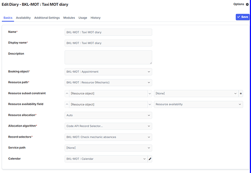

The logic within the API Record Selector is:
  1. Extract the requested booking date and time.
  2. Retrieve all mechanic resources.
  3. Check each mechanic’s resource availability.
  4. Check each mechanic’s absence records for conflicts.
  5. Remove any mechanics who are unavailable.
  6. Return a randomly selected mechanic from the remaining available resources for assignment.

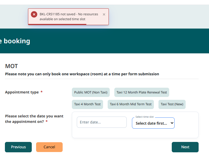

Issue to resolve:
The remaining challenge is handling scenarios where no mechanic resource is available. Currently, the user can select a time slot from the diary dropdown, but when they proceed to the next step of the form, they receive the system message:
“BKL-CRS1185 not saved - No resources available on selected time slot.”
The question is whether this message can be customised or whether the unavailable time slots can be removed from the dropdown before the user selects them.
I have looked at using cs.alert, but this does not appear to work when called from within the Record Selector.
Amara
I have resolved the alert issue.
The fix involved adding a fragment validator to the Start Field on the Booking object to check the selected input against absences, mirroring the logic from the previous record selector code.
This change achieves the following:
  • Replaces the standard alert with a custom message.
  • Displays an on-screen error if a date/time is selected where no resource is available.
  • Triggers an error if a date more than 30 days in advance is selected.

            cs.log("DYNAMIC MECHANIC CANDIDATES (" + candidates.length + "): " + JSON.stringify(candidates));
            if (!candidates.length) {
                return {
                    valid: false,
                    error: "No technicians are configured in the system."
            // 3. FETCH BOOKINGS
            let bookings = cs.search({
                base_object_id: cs.ref('bkl_mot_appointments_booking_object'),
                selects: {
                    start: cs.ref('bkl_mot_appointments_booking_start'),
                    end: cs.ref('bkl_mot_appointments_booking_end'),
                    resource: cs.ref('bkl_mot_appointments_booking_resource'),
                    status: cs.ref('bkl_mot_appointments_booking_reservation_status'),
                    reservationtimeout: cs.ref('bkl_mot_appointments_booking_reservation_timeout')
                return: 'data'
            // 4. FETCH ABSENCES
            let absences = cs.search({
                base_object_id: cs.ref('bkl_mechanic_absence_object'),
                selects: {
                    mechanic: cs.ref('bkl_mech_absence_mechanic'),
                    start: cs.ref('bkl_mech_absence_start'),
                    end: cs.ref('bkl_mech_absence_end'),
                    startdatetime: cs.ref('bkl_mech_absence_start_date_and_time'),
                    enddatetime: cs.ref('bkl_mech_absence_end_date_and_time')
                return: 'data'
            let availableMechanics = [];
            // 5. EVALUATE OVERLAPS
            for (let i = 0; i < candidates.length; i++) {
                let mechId = candidates[i];
                let blocked = false;
                // Check Bookings
                for (let j = 0; j < bookings.length; j++) {
                    let booking = bookings[j];
                    let resourceId = booking.resource && booking.resource.id ? String(booking.resource.id) : String(booking.resource);
                    if (resourceId !== mechId) continue;
                    let status = String(booking.status || "").toLowerCase();
                    if (status !== "secured" && status !== "provisional") continue;
                    if (status === "provisional") {
                        let timeout = Number(booking.reservationtimeout || 0);
                        if (timeout <= now) continue;
                    let bStart = toMs(booking.start);
                    let bEnd = toMs(booking.end);
                    if (bStart && bEnd && (bStart < end && bEnd > start)) {
                        blocked = true;
                        break;
                if (blocked) continue;
                // Check Absences
                for (let k = 0; k < absences.length; k++) {
                    let absence = absences[k];
                    let mechanicId = absence.mechanic && absence.mechanic.id ? String(absence.mechanic.id) : String(absence.mechanic);
                    if (mechanicId !== mechId) continue;
                    let aStart = (absence.startdatetime && absence.enddatetime) ? toMs(absence.startdatetime) : toMs(absence.start);
                    let aEnd = (absence.startdatetime && absence.enddatetime) ? toMs(absence.enddatetime) : toMs(absence.end);
                    if (aStart && aEnd && (aStart < end && aEnd > start)) {
                        blocked = true;
                        break;
                if (!blocked) {
                    availableMechanics.push(mechId);
            cs.log("AVAILABLE MECHANICS COUNT: " + availableMechanics.length);
            if (availableMechanics.length === 0) {
                return {
                    valid: false,
                    error: "No technicians are available at your selected date and time. Please select another slot."
            return true;
        } catch (err) {
            cs.log("ERROR: " + err.message);
            return true;
