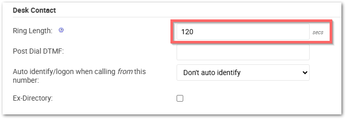

Hi @jhill. You are correct that the Template settings are for New Contacts, but if you want to make a global change, you can set the value in the field you want. In this case, I want to change the Desk Ring Length from 30 to 120 seconds.

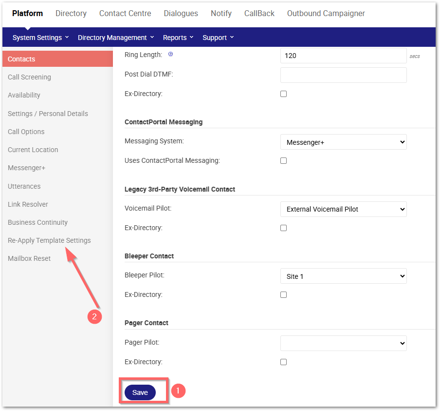

I can then scroll to the bottom of the page and click Save, and then I can click Re-Apply Template Settings on the left-hand side.

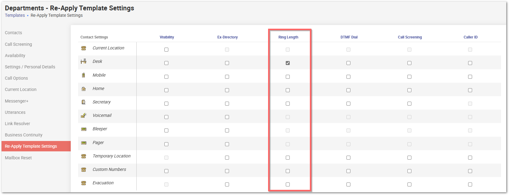

I can then tick the required box that I want to change for all Entities within my Template. (Ring Length - Desk in this example)
Then I scroll to the bottom and click Re-Apply

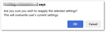

These changes will affect all entities in the Template, overriding any other personal settings an Entity has. The change is irreversible, and you should always be 100% sure you are happy to make it before clicking the Re-Apply button.
I am asked to do this with a confirmation dialogue box. Click OK to continue.

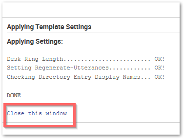

A separate window will pop up telling me the progress, and when it is complete, I can click on the Close This Window link.
Now, all your entities should have the new ring length. Repeat this for any other templates you want to adjust.

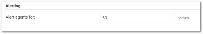

Please note: This will only affect calls being transferred to these entities. If you want to change the ring length of the time it takes for a Contact Centre call to be answered by an Agent, you should do that within your Contact Centre Group Settings.
