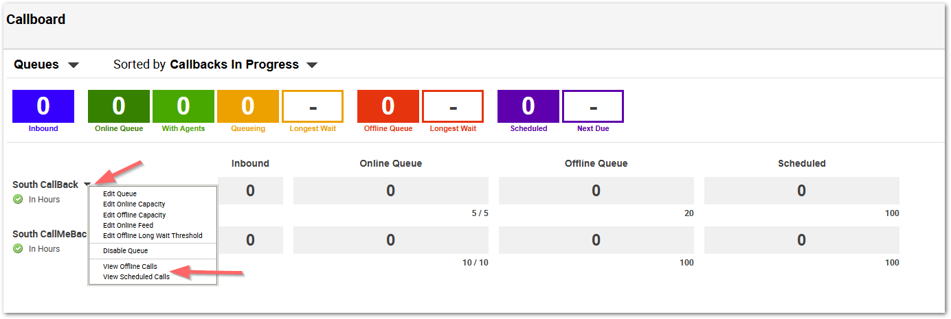

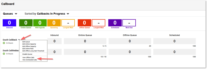

Hi @CathyS yes it is. But you can only do so from the CallBack area of the system.
On the Queue in question, you cal click the down arrow and you will see, offline and scheduled calls that you can view.
Select the one you want, and then click the delete button next to the number you want to delete.
Of course, this does require a customer to tell you that they have a CallBack waiting, as you wouldn’t know otherwise. - Be a handy idea that should you want to add it to the ideas portal :slight_smile:

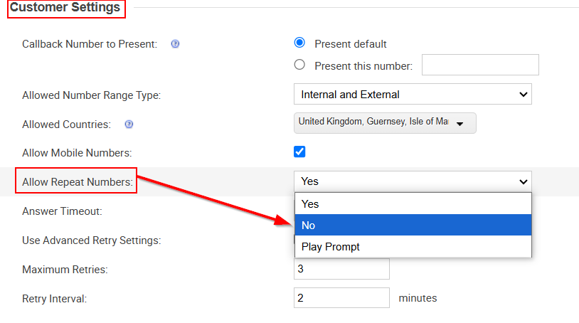

Additionally to Jonathan’s reply above, there is a setting in the CallBack group itself (Customer Settings > Allow Repeat Number) to prevent new callback requests from the same phone number if that would help:
