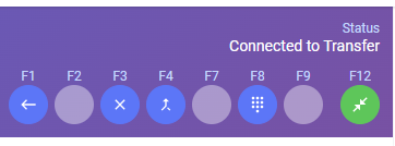

Hi @FeenoAye, can you advise a little further? When I look at this, I answer as a Switchboard Agent. I use the Transfer to a Queue and the Queue Answers. I then have the following icons at the top to allow me to control the call: I can use F1 to go back to the caller, F3 to cancel the transfer, F4 to conference, and F12 to complete the transfer.
Is this not what you are seeing?

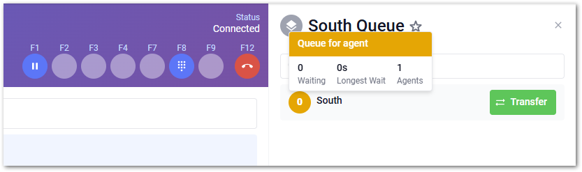

Hi Jonathan, thanks for getting back to me. The issue our agents are having is in between them ringing and the queue answering. They are waiting for the queue to answer, if it is a long wait they would perhaps go back to the customer, but what they are noticing here is they can only cancel the call and leave the queue, they cant go back to the customer and retain their position in the queue. If the call is connected to an agent at the other end of the queue, then they do see these options.
Ahh I get it. So, yes it does this as it knows it is a queued call. You choose to cancel or complete the transfer. To help if the operator clicks on the queue name you will see the queue details so you can advise the caller before transferring them and either choosing to wait with them or completing the transfer to release the operator.
