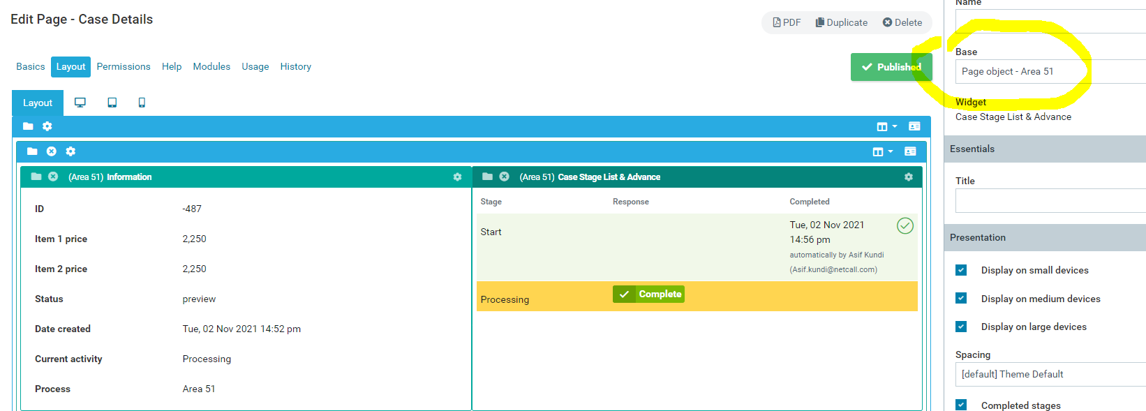

but please check if you have the case object as the ‘Base object’ for your page or subtab or the viewport (whatever is appropriate in your scenario).
Also I believe you must have checked that you are showing the ‘correctly selected’ process under the relevant page with the relevant Base object applied.
I have just tested your scenario and there doesn’t seem to be an issue with displaying the widget ‘Case Stage List & Advance’ as per the screenshot below:
