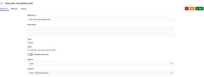

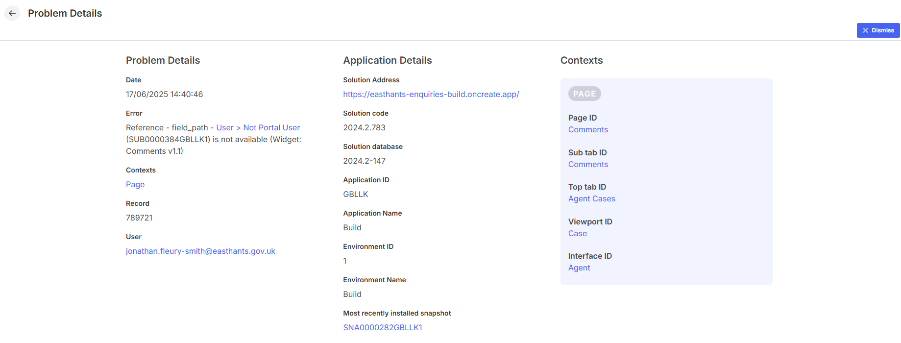

This isn’t working either, I get 2 errors shown below when I add in the additional filter for the subset.

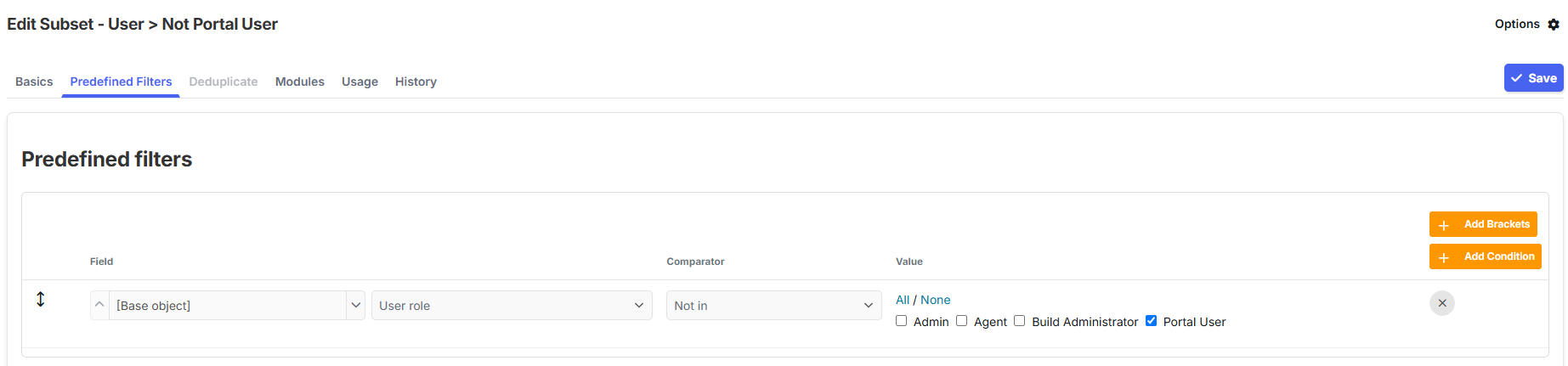

I have a subset on User object named User > Not Portal User
And a Code Studio Subset Reference named
			var r = mats.search({
				'base_object_id': user_list_object,
				'selects': db_selects,
				"groupings": []
				, 'filters': [
					{ 'field_path': ':status', 'value': 'active', 'comparator': 'equal_to' },
					{ 'field_path': cs.ref('sub_user_not_portal_user'), 'value': '1'}
				//,"return" : "data"
This is first error detail
Is this the correct way to use a subset via a field_path filter?
                'filters': [
Thanks for your help @adam.mills

Hi Jonathan,
Is sub_user_not_portal_user a path from user_list_object which is the base, if not that may well be the problem, you need to create the reference to the subset from user_list_object through.
Adam
I believe the user_list_object is actually the User Object, as this is how its been setup in the Comments Widget I got from AppShare (but I dont understand how’s it setup in the code), I have set the subsets on the User Object but these aren’t accessible due to setup.
