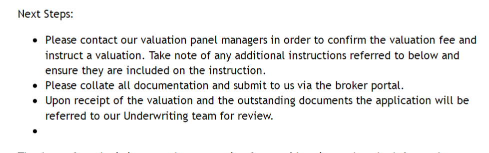

Hi all,
I am trying to add a conditional subset onto some text in a bulleted list on a template, however anyway I try to add the conditional it will take out the text but leave in the bullet point formatting even when blank, is there a way to remove the bullet point too?
Any ideas are appreciated!

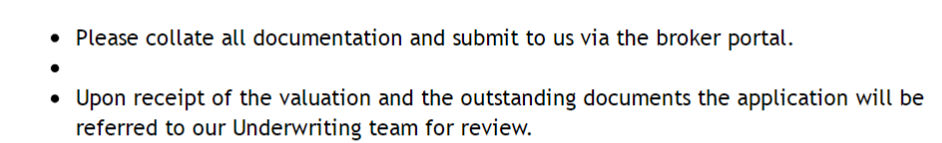

These were my outputs for both:
Let me know how you get on,
Dan
