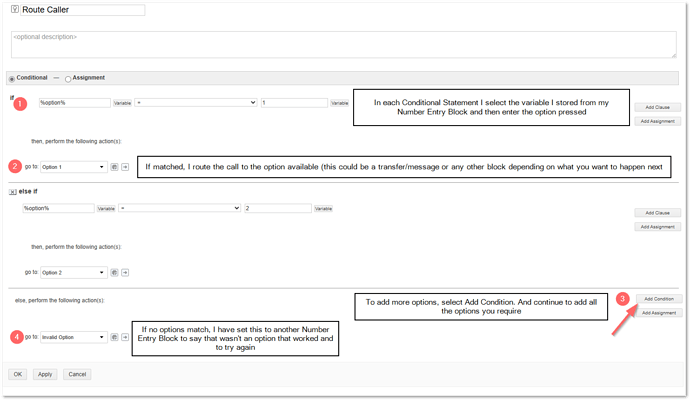

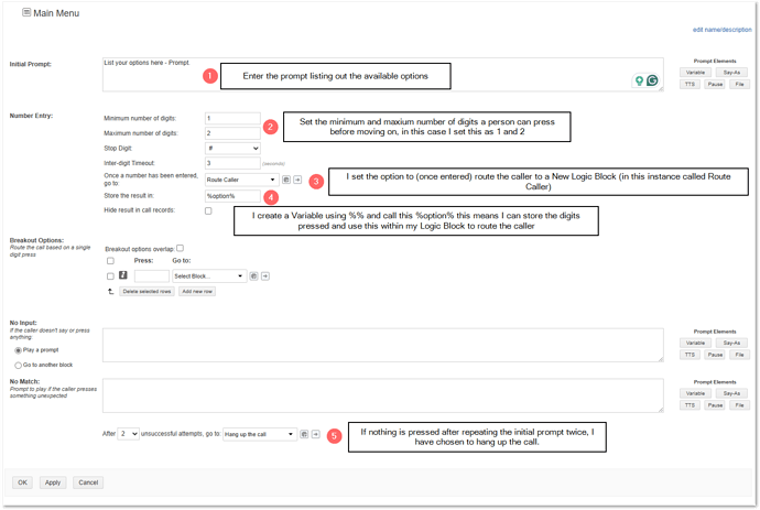

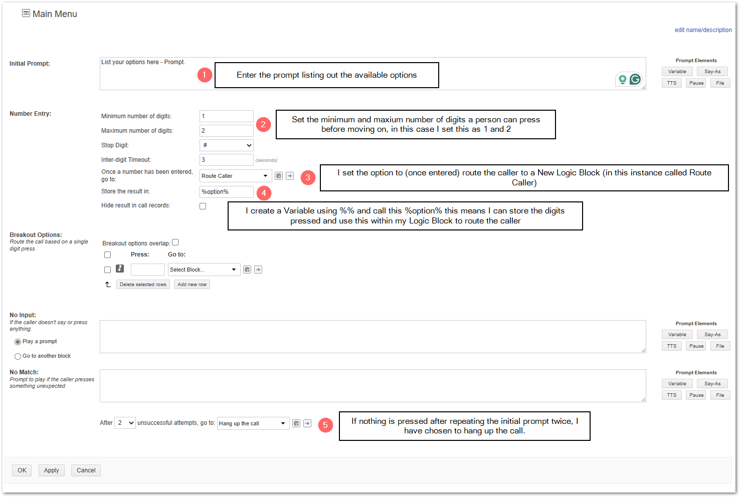

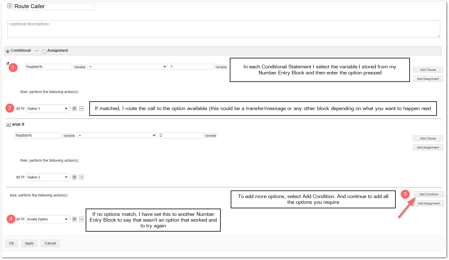

In the meantime, how do I go about getting this to work. I understand how the logic block works and how to store the value, (I have used this to enter and dial an internal extension number before) but I’m not sure how to translate this into a transfer to different potential options.
Hi Andy. To create this, you will need a Number Entry Block, and this is how I would set this up:
Number Entry Block
Logic Block
This way, you can add as many options as you want and then route these as required. I will add that it would be much better to separate these options, as cognitively it would be easier for users to get to the area they need.

Many thanks @JonathanRedsell , this is exactly what I was looking for.
