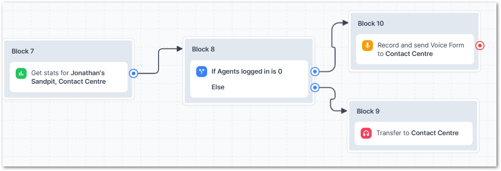

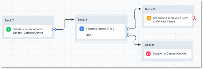

Once the queues are in place, you can use a Query step to check whether there are any logged‑in Agents for a given queue. From there, a Decision block can be used to route the call accordingly.
In practice, this means repeating the same pattern for each Agent:

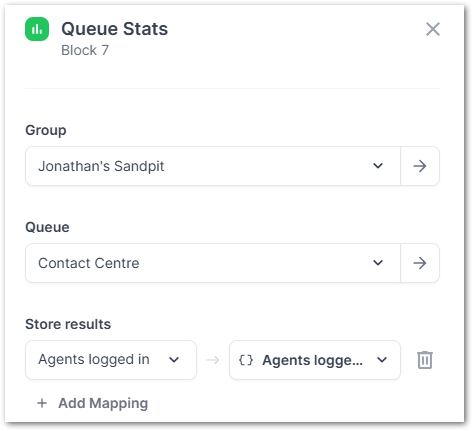

  1. Add a Query block
  2. Select the relevant Group and Queue
  3. Store the number of logged‑in Agents in a variable (for example, Agents Logged In)

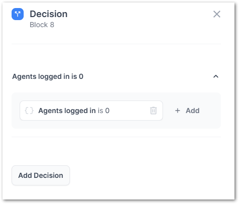

You can then follow this with a Decision step that checks whether Agents Logged In equals 0.
  • If the value is 0, route the caller to a voice form
  • Otherwise, send the call through to the Agent
If it is 0 - Go to the Voice form if Else, then go to the Agent.
