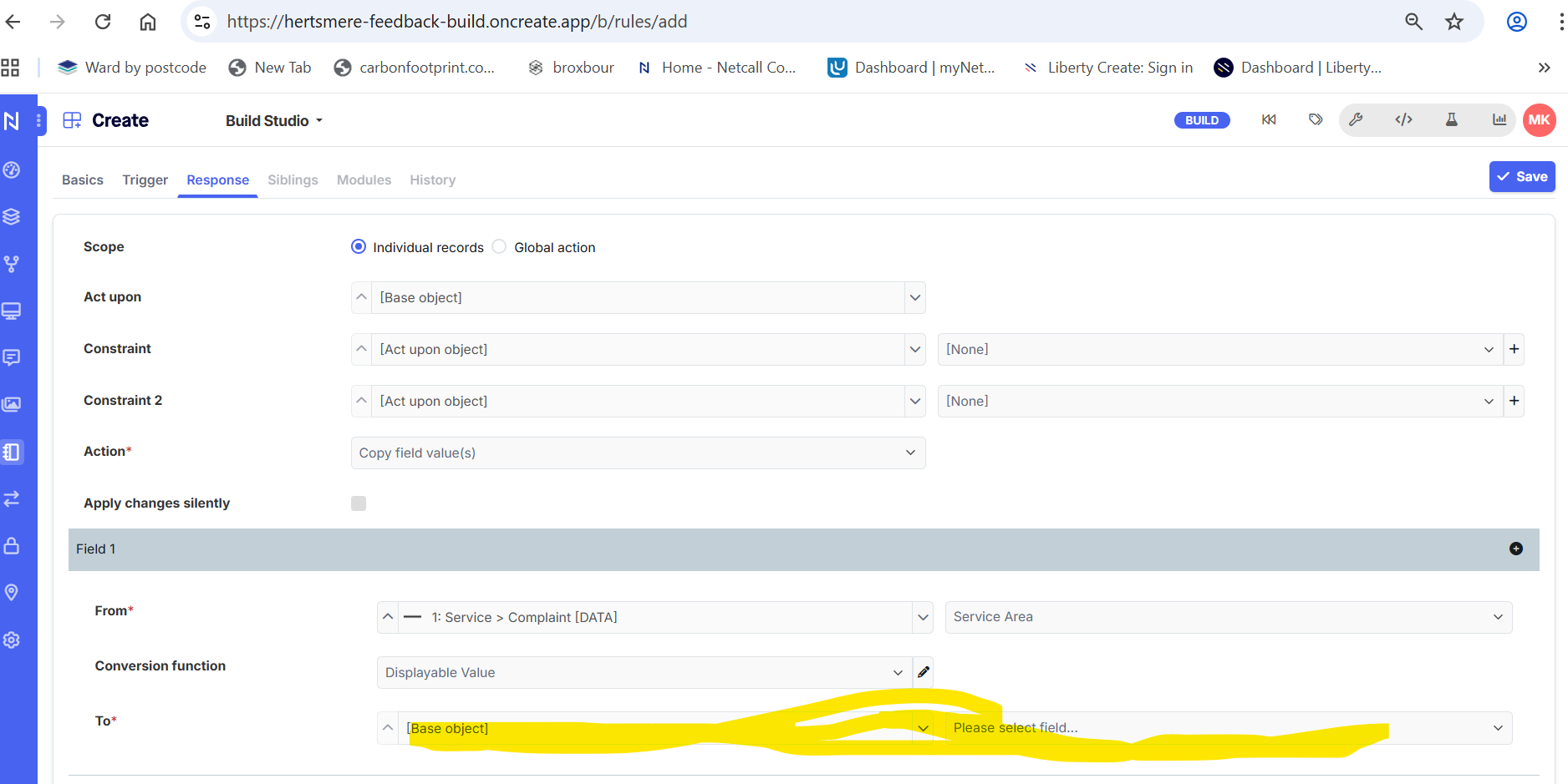

Hi again Kev
There’s only one API call related to Hub on the Feedback app. (Create or Update Summary Case - Liberty Create: Sign in ). You have said ‘just modify the existing call from feedback to hub’. But there’s no place to update the API call.
I added ‘Service area’, ‘Waste service type’, ‘Type of bin’, and ‘Bin collection day’ properties within the ‘CASE SUMMARY DATA’ object (Liberty Create: Sign in) on Hub. Then I’m trying to create a rule within the Feedback app to copy these values from ‘Complaints [Data]’ object to ‘Case summary Data’ object at form submission. But I’m unable to locate the ‘Case summary Data’ object within the feedback app.
Am I doing it correct?
Mihiri
ON Central the object is named CASE SUMMARY DATA , and on all hosts it is named CASE.
