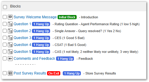

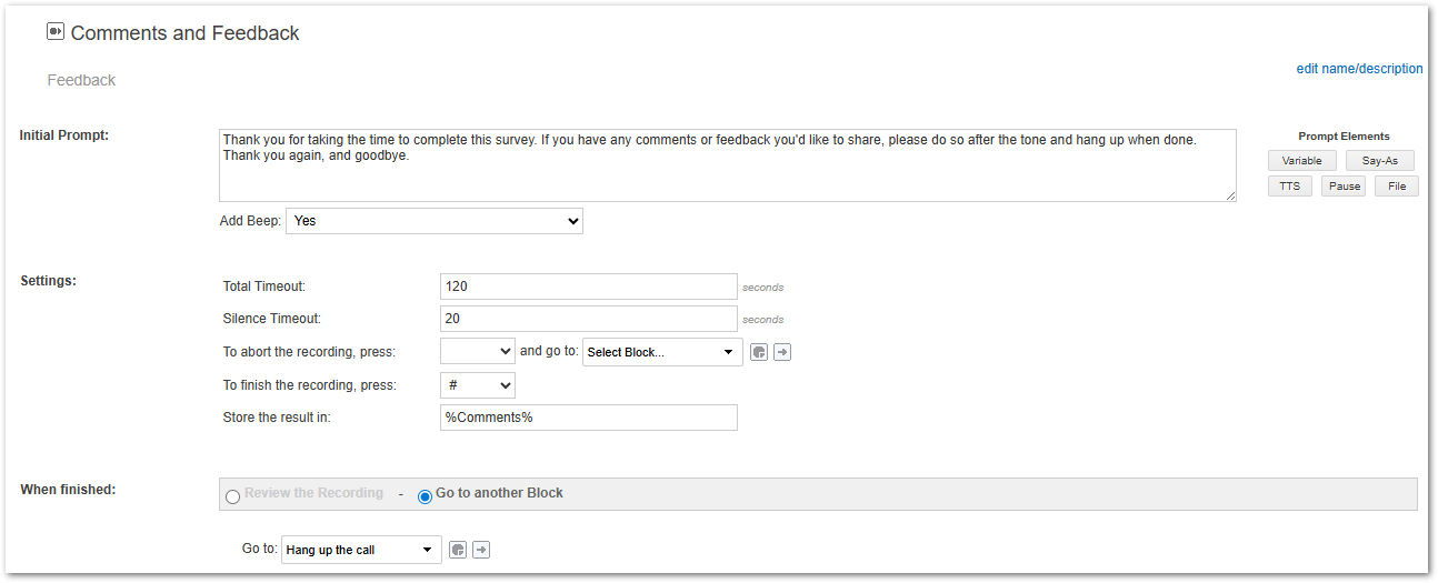

HI @Rebecki This is typically seen when you have a survey that loads your Post Survey Results block twice.
To double check if this is the case here is an example Survey,

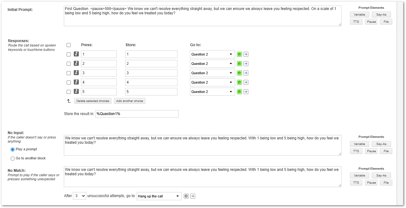

Each of my questions go to the next question or hangup if the user does not engage with the question after two attempts.

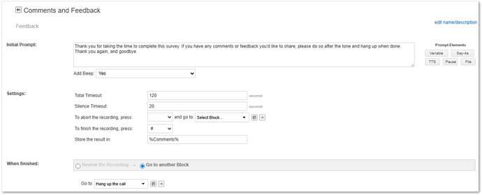

My final comments block, once captures, also hangs up and does not go to any other block

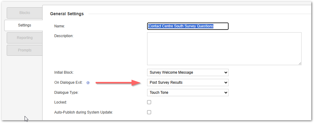

This is because my Post Block is set to trigger On Exit. This means when the call ends or the user leaves the Dialogue. I set this within my Dialogue Settings
If I have any other Block load the Post block before the caller hangs up or as the Dialogue ends, it will then trigger the Post of Survey results. Meaning, the Dialogue post the results and then it also posts when the caller hangs up as that is the setting.
So, make sure your Dialogue is not loading the Post Block any other time than On Exit and that should stop you getting double results.
