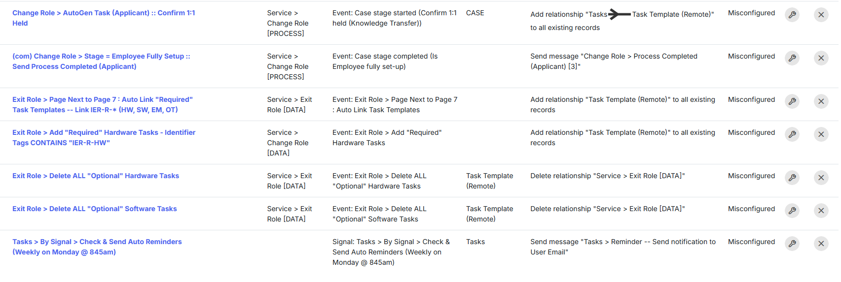

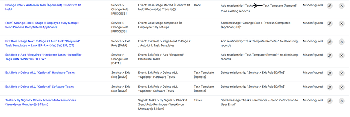

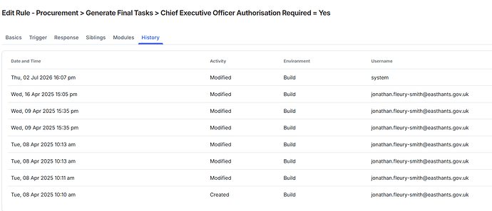

Had a strange bug today which I traced to multiple misconfigured Rules (and therefore they had all been disabled).
I would like to know how they become misconfigured as I can’t save a rule in that state, and none of the subset constraints have changed AFAIK.
All of the Rules that were misconfigured were related to a Remote Object “Task Template” if that helps in some way diagnosing the issue.

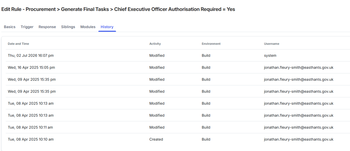

I note that the last update was by the system, not me? All of the misconfigured rules are updated by the system on Thu, 02 July 2026
Can anyone explain when a system updated is applied….? Is this a snapshot install, an update, a patch???
I know I’ve done something wrong, but would like to figure what to stop this happening in the future.

In your case I imagine these rules were already broken, and this System change was simply them being flagged as Misconfigured to help indicate this.

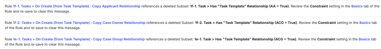

Looking at the validator log, it is saying a subset was deleted….when it clearly was not.
It looks like some of my Rules lost visibility of the subsets? how can this happen.

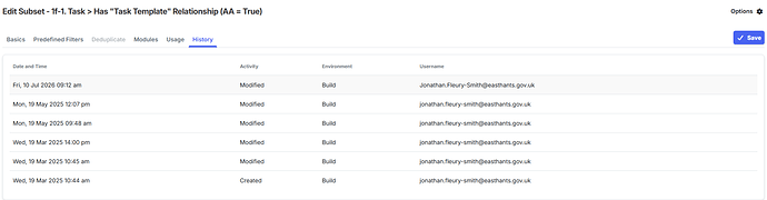

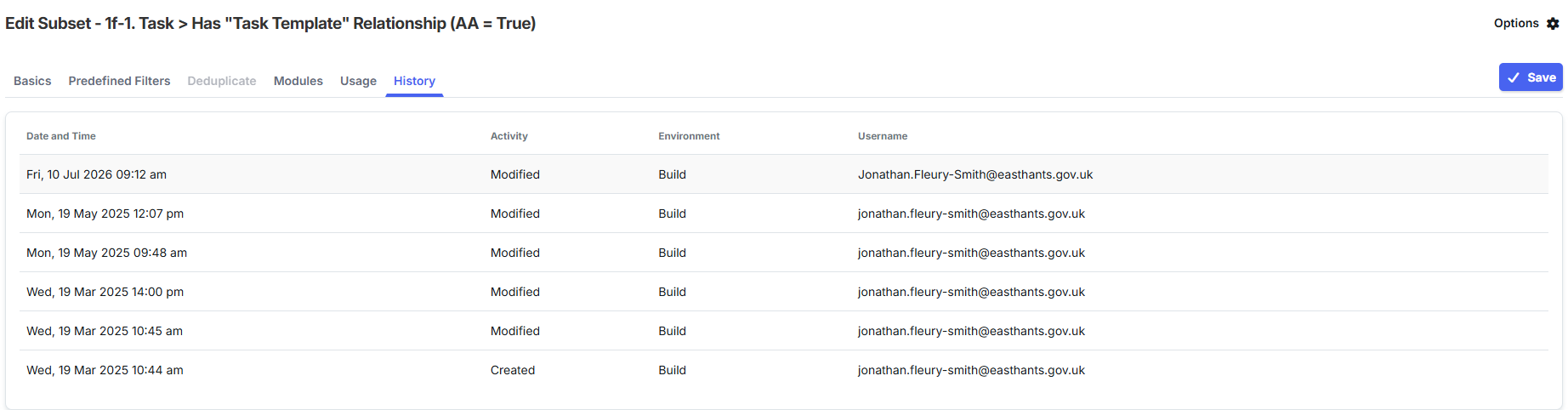

Each of the Rules that was marked as misconfigured uses only 1 subset, and they have existed since 2025.
The update by me today, was me simply opening the subset and saving that to see if had zeroed out or something?
