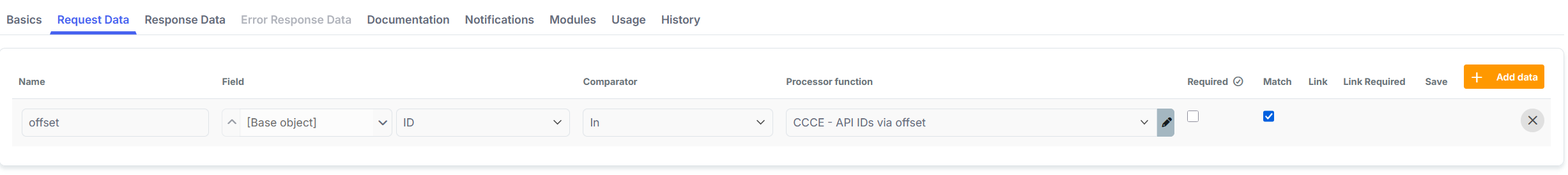

I managed to do something like this by included a request variable that internally was a list of IDs for records to provide in the response, but was portrayed externally as an offset. I then had a data processors on the line that ran a cs.search to pull back a list of IDs with a fixed limit of 1000 records and return this as part of the response. I hadn’t though about the possibility of returning duplicates so might need to add an order parameter to the search, and even then it probably wouldn’t be perfect. In theory the same trick (internally asking for one thing whilst externally asking for another and using a request field processor to translate) could be used to request 2 input fields and possibly to provide a count of records returned on the ouitput.
 * Field Processor
 * Processes individual columns within a set of data, typically within
 * imports/exports and API calls/handlers
return {
	 * @param {string} input The value to be processed
	 * @param {Object} params Additional context parameters
	 * @returns {string} The processed value
	main: function (input, params) {
		cs.log(`CCCE - API IDs via offset`)
		cs.log(`input=${input}`)
		cs.log(`params:`)
		cs.log(params)
		let api_ids = []
		if (input) {
			api_ids = cs.search({
				'base_object_id': cs.ref('object_case'),
				'selects': {
				'filters': [{ 'field_path': cs.ref('field_case_subset_ccceCASECaseTypeLCCFeedbackFormComplete'), 'comparator': 'equal_to', 'value': 1 }],
				'limit': input + ',1000',
				'return': 'column'
		} else {
				'selects': {
				'return': 'column'
		cs.log(`api_ids:`)
		cs.log(api_ids)
		return api_ids
