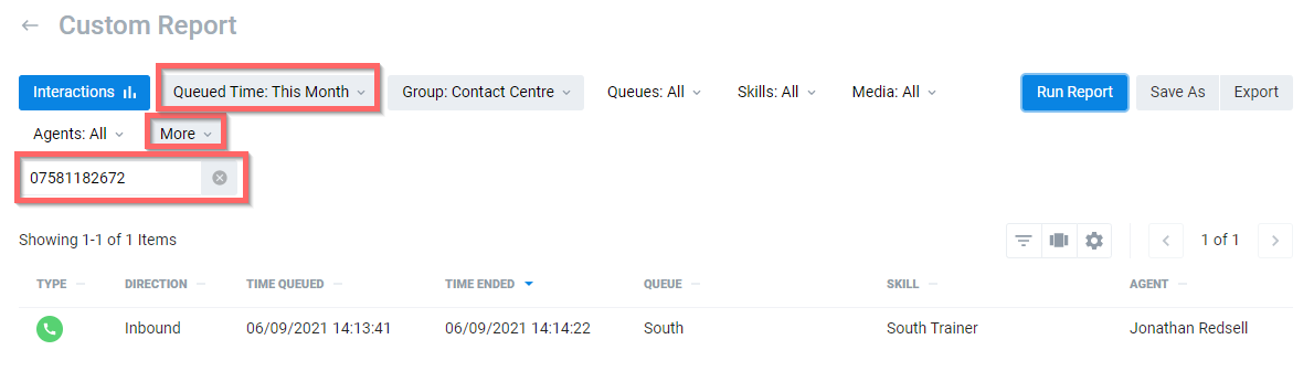

Hey, You can view all inbound/outbound interactions using the Interactions report.
If the Agent made/received a call through the Libetyr Converse Contact Centre software, then it will be displayed within this report. If not, then it did not go through the software/system.
You can use the Queue Time to select the time period to search through/display, use the More option and use the Customer field (tick the box) that will then enable you to search for the phone number.
Here is an example.
Great, that worked, thank you!
