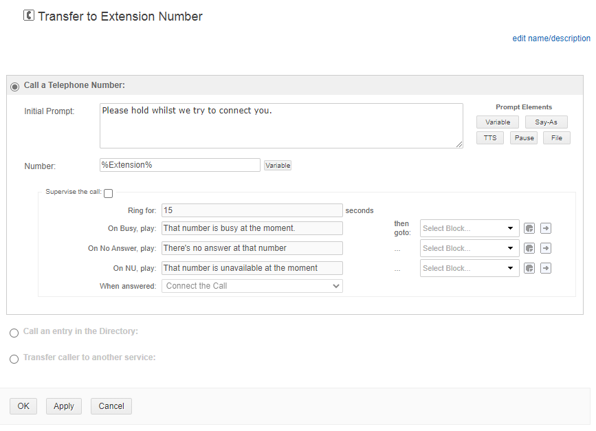

  1. In the Transfer Block, I put a message telling the caller what is happening and then in the Number field, I add in my Variable. I can do this by entering it as I created it above (%Extension%).
Or I can click on the Variable button and select it from the Block Results option as shown.
That’s it. I click OK to close and save the Block.

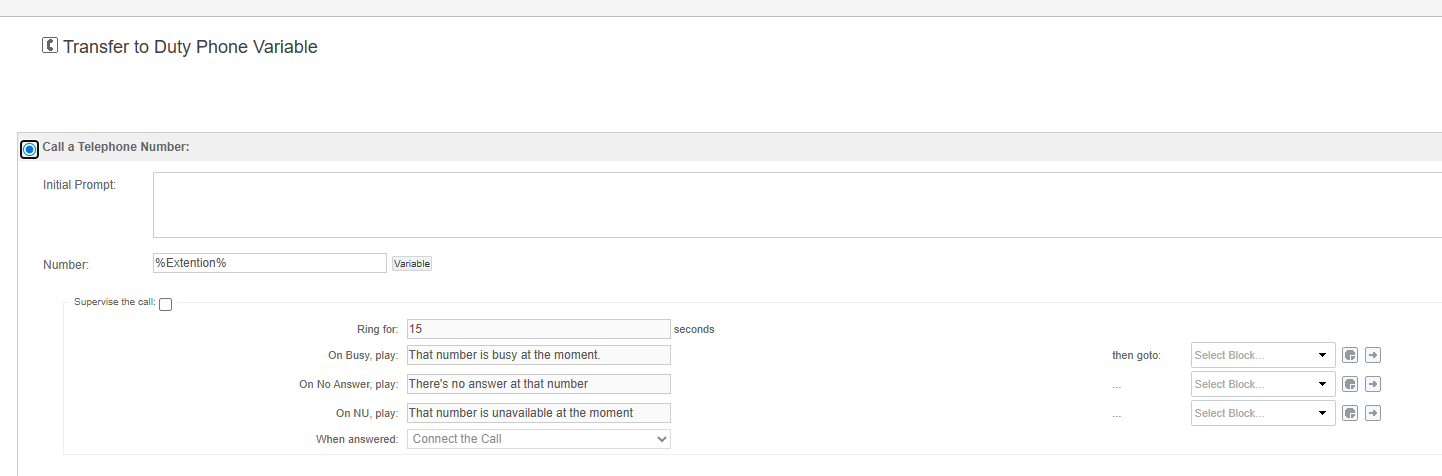

So for for my use case I have a duty phone which my dialogue forwards to but that is changeable now depending on what consultant is on duty which has a scheduled structure but not one that would work with a time plan!

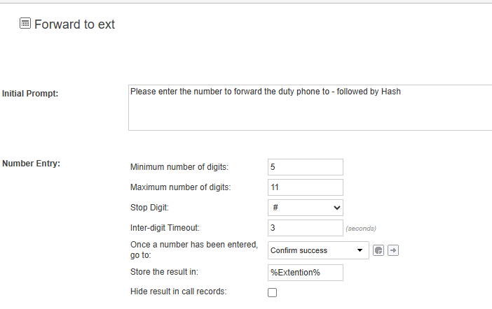

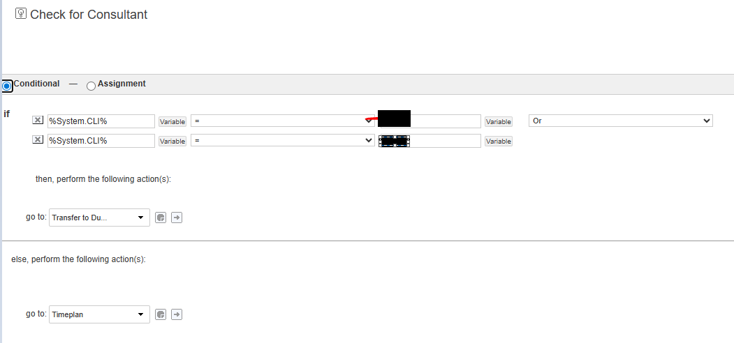

What I have done - I have put a logic check in to see if either of the duty consultants are calling in to the pilot number which reaches my dialogue and if seen they are presented with the option to set the forward to extension block.
My idea here is that they can call in to set the forward block to their desk phone when they are on duty and the dialogue would forward to them as everyone else that calls in goes direct to the timeplan which then follows through other processes including ending at the transfer.

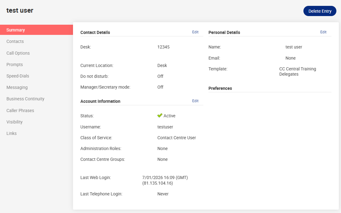

As you can see, I’ve added a Test User and given them a user account. The only other step to check is that this user has a Class of Service assigned which allows them to log in and change their location.
This ensures they have the right permissions to update the forwarding number when needed.

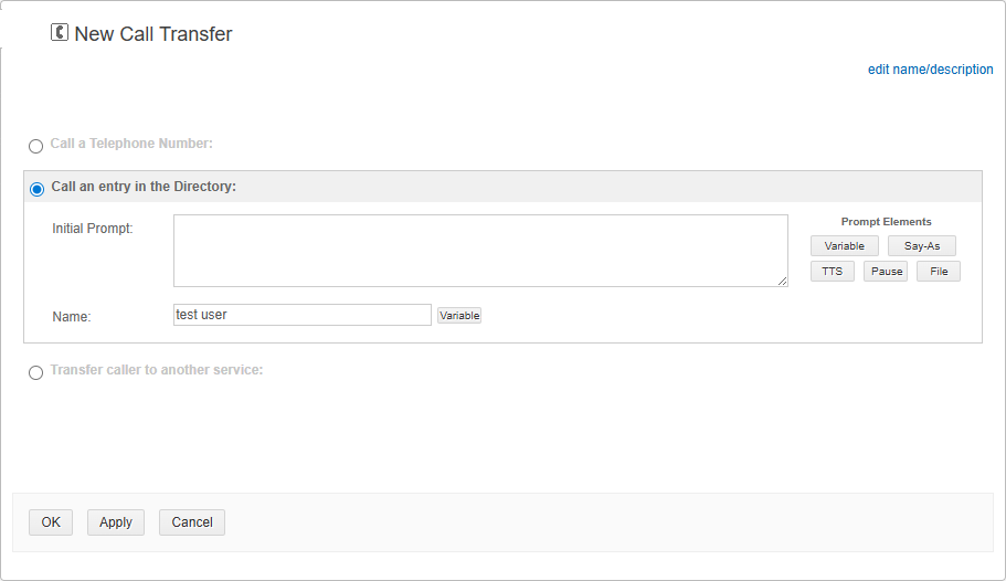

In the Dialogue, I go to my Transfer Block and set it to “Call an entry in the Directory.”
For the name, I select Test User. I don’t choose any specific option like Desk or Mobile—just the main entry. This ensures the call always goes to the user’s current location, so when they update their location, the transfer automatically follows.
This works because the Transfer Block is designed to route calls based on the directory entry rather than a fixed number. So, as long as the authorised user updates their location, the system will forward calls correctly without needing to change the dialogue itself.

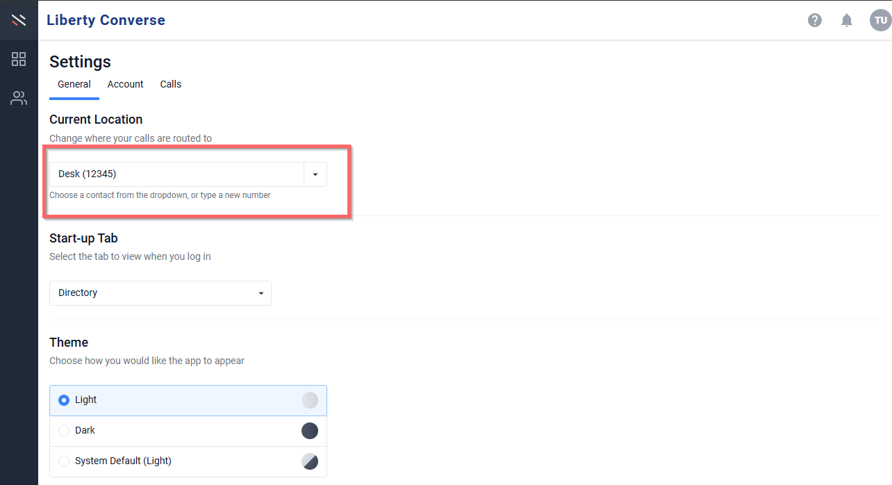

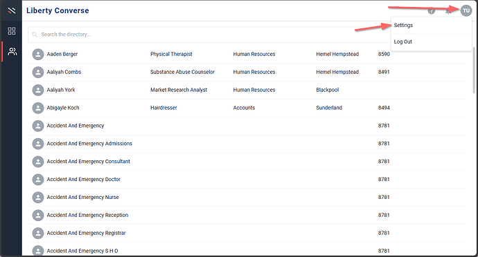

When the “admin” user logs in, they just need to click on their avatar in the top-right corner and select Settings. From there, they can update their location details, which will automatically change where calls are forwarded—no need to edit the dialogue itself.

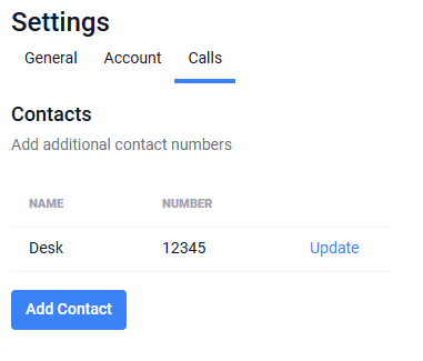

Under Current Location, they can either select the default desk from any predefined numbers or simply type in the number they want calls to go to, replacing the existing location. It’s quick, simple, and keeps everything flexible.
What’s more, if they have the right permissions, they can go to the Calls tab and add extra numbers. These will then appear in the drop-down list automatically, making it even easier to select the correct forwarding option.
