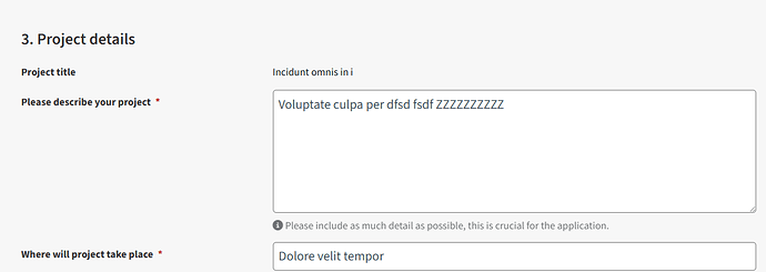

Does anyone know how you increase the min-height for an Input Text (Multi-Line) presenter?
I have used the Late Style sheet in the past to modify html elements, but I can’t seem to find the correct css override to increase text box to say 200px similar to this…
