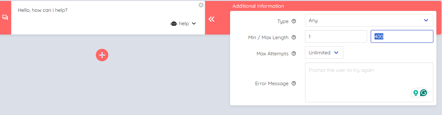

The FAQ system in Connect is designed to be checked given almost all inputs from the customer. The one scenario where we don’t send it to the natural language engine is when there is validation on the user input. So, for an example like yours, where you want to stay within the flow even if they say something that matches an FAQ, you could add a maximum length input:
This way the natural language engine will be ignored.

Thanks for that Luke, thats great.
