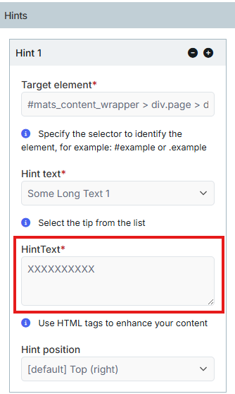

I am attempting to update a widget so I can use data from an object rather than a text field in the widget.
The old get_settings looked like, and a text input is displayed on the widget to enter html.
	hintText: {
		main_label: "HintText",
		csid: "HintText",
		base_format: "text",
		settings: { required: true, hint: "Use HTML tags to enhance your content" },
Text input on widget:

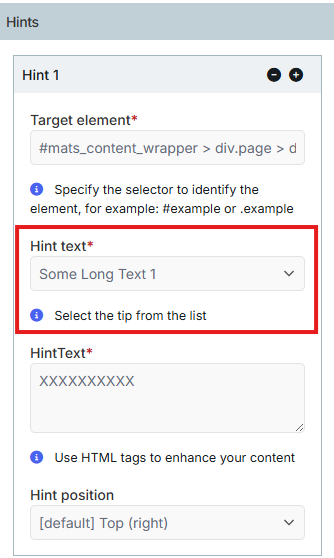

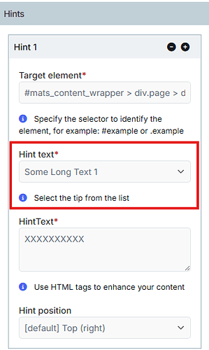

In the new get_settings I want to to load a list of Guided Hints from an object.
	hint: {
		main_label: "Hint text",
		csid: "Hint text",
		base_format: "choice",
		choices: hint_choices,
		settings: { required: true, hint: "Select the tip from the list" },
Choice list on widget showing dummy values
The problem I’m having is when I try and load data into hint_choices in the get_settings function it loads dummy data with negative ID’s (I’m guessing this a scope problem…?)

I’ve tried moving the code to different parts of the widget, but cant figure out how I pass the hint_choices into the get_settings function.
So what I’m asking is how do I populate hint_choices with the actual data, not the dummy?
I don’t think this will be possible using record data.
Build Studio cannot access any “real” record data. If you try to perform a cs.search within get_settings, as you have found, you will only ever get the dummy data (which is also shown in the widgets when you are building a page for example).
That aside, the data would also be different from environment to environment, so using it as a value in a setting would then potentially break when promoting to another environment with different values.
Thanks Bob, I was hoping this wasn’t the case.
Appreciate the knowledge as always.
