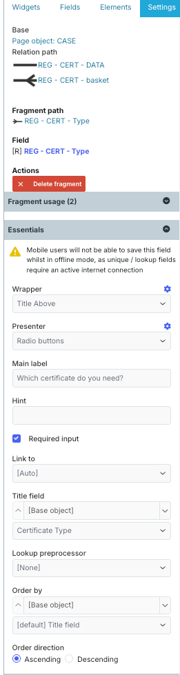

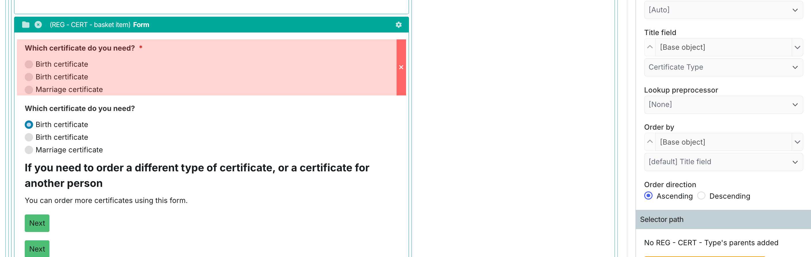

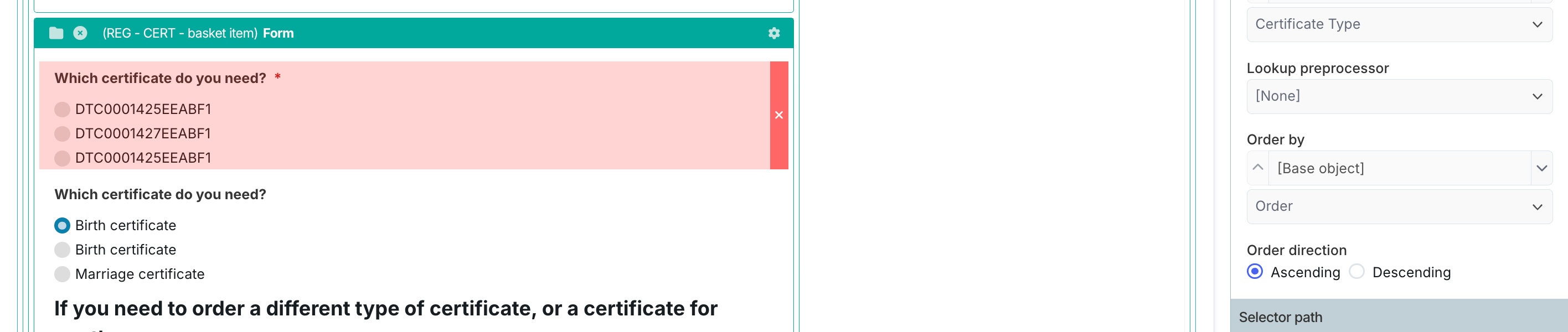

Does anyone know if a list of radio buttons can be ordered by either attribute order, or a property called order? When i try to apply the ordering attribute, it reverts to using the DTC as the displayable text

Is this the standard “Input radio” presenter?

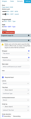

The “Lookup preprocessor” and “Order by” options look out of place in this context. Could you post the full settings panel maybe, to see if anything else stands out?
It’s selecting a certificate type from another object (as it requires additional data like price), so not getting the data from a regular choice datatype

I notice there is some code to set the order, but looks like there may be a bug in it
Nothing immediately stands out as wrong here, the ordering logic seems simple enough, but obviously there are other files involved too. Maybe an issue in the frontend code possibly, if it’s causing the wrong text to be shown for the options. Is frontend.js doing anything with the options data maybe?
