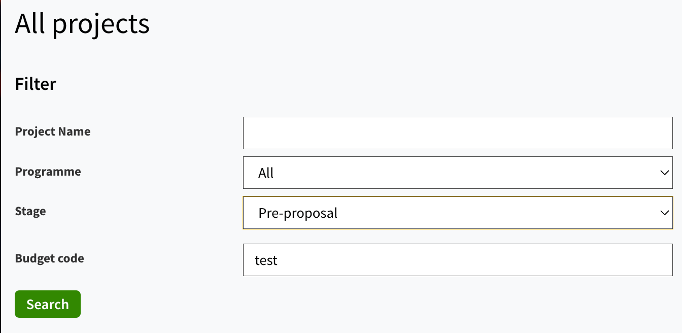

In this pic, selecting stage pre-proposal shows the widget with budget code, with the default value already set. Different choices will show different widgets, so you can have as many sets of predefined filters as you need. You could have a search widget with no defaults for when no choice is selected,
