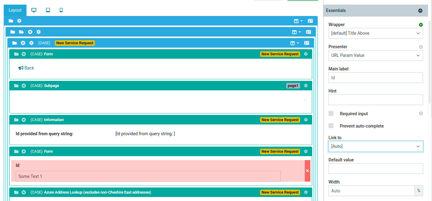

Sorry, but this is not the behaviour I am looking for.
I have a url like this:
https://cheshireeast-core-build.oncreate.app/w/webpage/request?form=dummy_form_mark&id=abcde
I want to be able to use that id on my form.
I can display the additional parameter as you can see below, but the presenter is not picking it up.
Hi Mark,
The issue is clearly with the URL redirection, the id is being stripped on redirect.
If you add it to the resolved redirect the presenter works as intended.
Where is the URL you are providing coming from and we can see if we can preserve extraneous URL params.

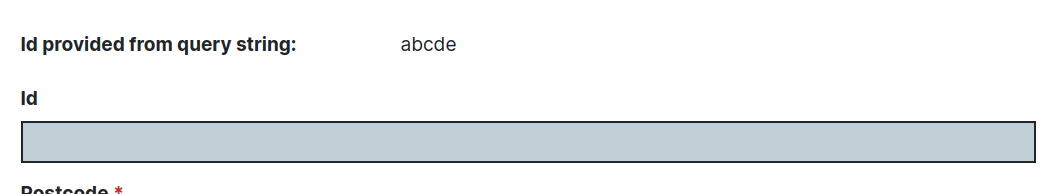

Thanks Adam. That url is on the start page of my form.
I have set up “additional parameters” to capture stuff from the referring url’s query string. How can I access these from the presenter?
Mark
I have created the behaviour I need using a Fragment Callback. It’s not ideal as I don’t have the ability to set the parameter key in the interface.
