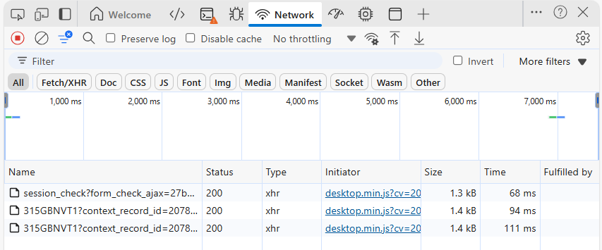

You should also be able to see the request triggered by your this.trigger_action() in your Browser’s Network debugging panel, to double check something is happening.

Yes, things are happening:
If I put console.log() above the this.trigger_action line, nothing is logged.
Ok so that is getting through, just spotted that you are using cs.fire_event rather than record.fire_event which I think is what you need.
