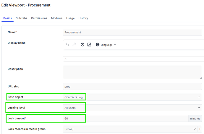

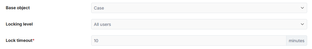

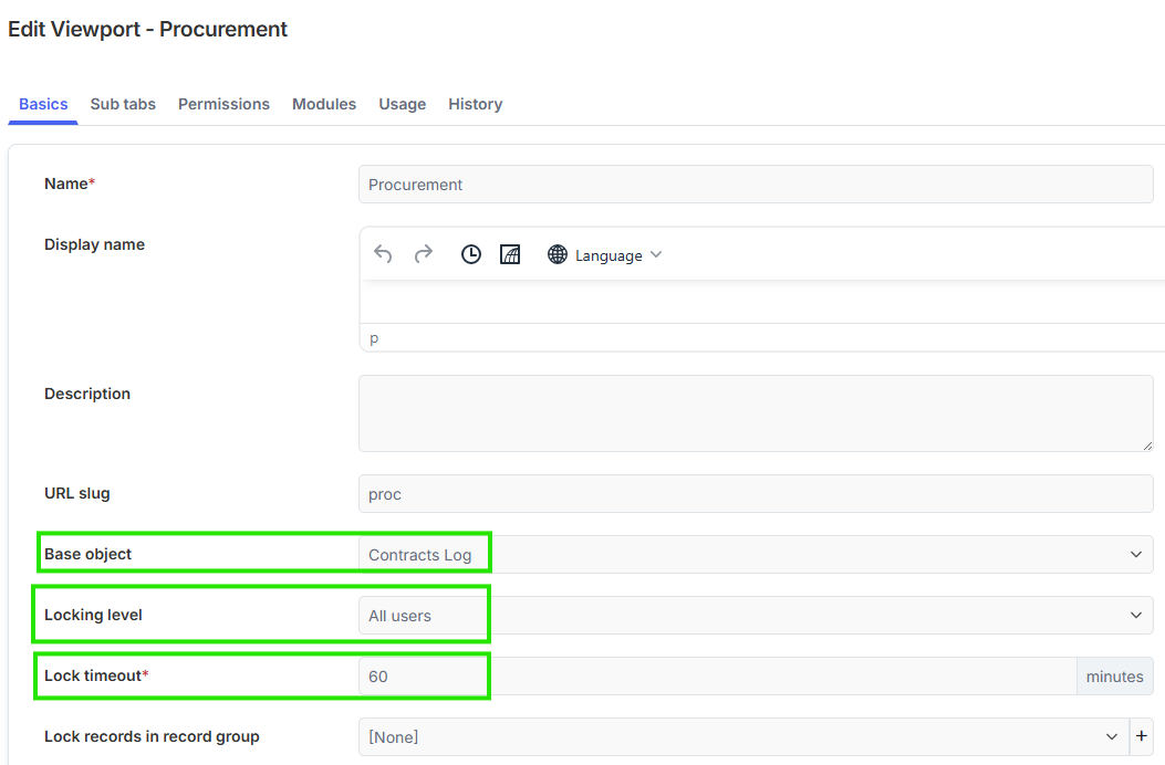

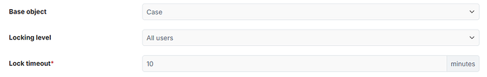

Yes, you can lock records at the Viewport level, such that only one user has editing control over a record while within any pages of that Viewport.
Have a look at the Basics tab of a Viewport, the locking options are available once a Base Object is selected. In your case the “All Users” locking option is probably what you want here, and you can set the lock timeout period.
Thanks Bob, I hoped there would be a way of achieving this.

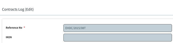

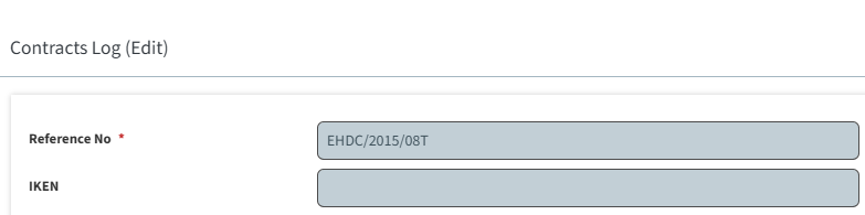

This was so easy to implement, I modified Viewport as you suggested (as shown)
And when a secondary user accesses a record being edited by primary user, all fields are greyed out (meaning they can’t edit)
Super easy to implement.
