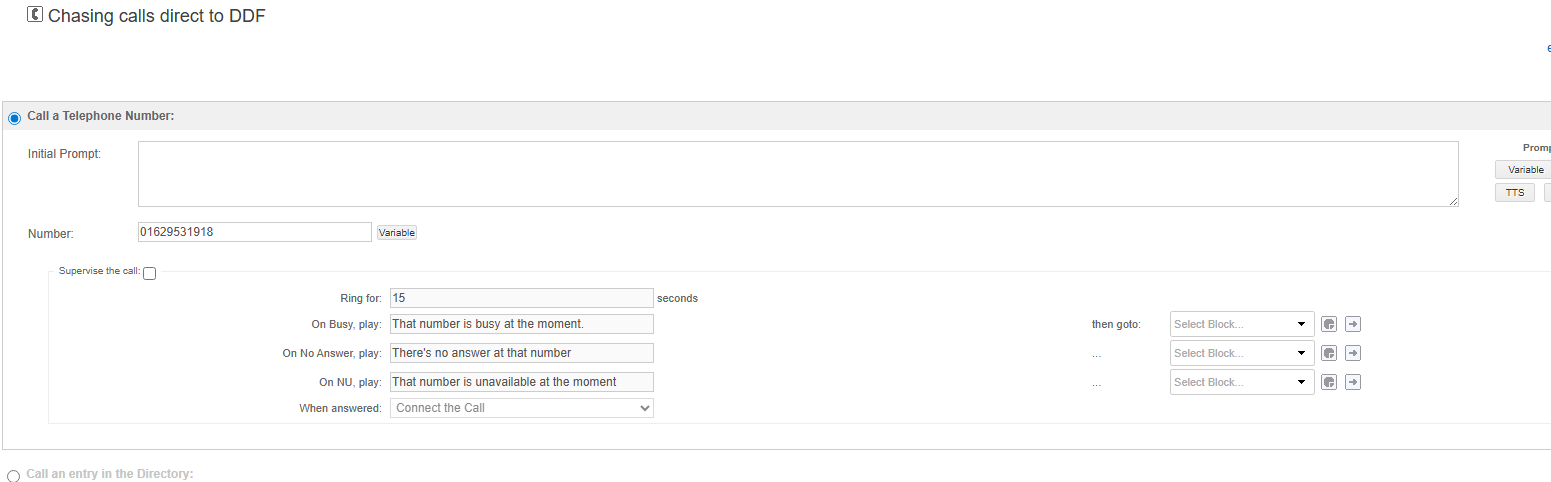

Thanks for this, I have a transfer block that calls out to another number and transfers caller, the boxes you should be able to click to ‘Select Outcome’ are greyed out so I can not set the report.
For a Dialogue they may look greyed out but you hover over the pie chart icon it should show you the option of setting or selecting an outcome.
If it doesn’t please do log a call with support as this is not the correct behaviour.
It shows as this and I can not select any of the ‘then go to’ options, the outcome icons or the grey arrows. Is this a fault or am I do something wrong? Thanks
Okay you don’t need to set for this - as you are calling a mobile you don’t need to enable the supervised transfer (this is why the outcomes are disabled, because the supervised transfer is not enabled). The actual Outcome will be set on the previous block where it is loading the transfer block. The Outcome is the transfer block.
Hope that makes sense.
