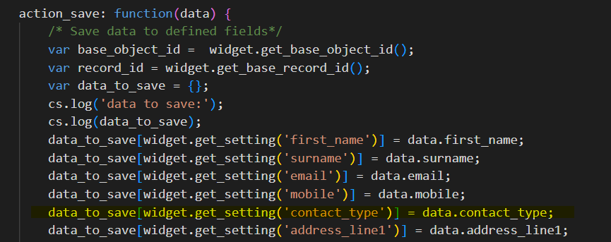

In main.js action_save method, have you defined the field path and value for your new radio button?
This is what I have:
So the setting called “contact_type” is the actual setting for picking your choice value that you want to save, right?
You need another setting so that you could define the actual field path where the “contact_type” value should be saved to, same way how the “address_line1” etc are defined.

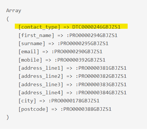

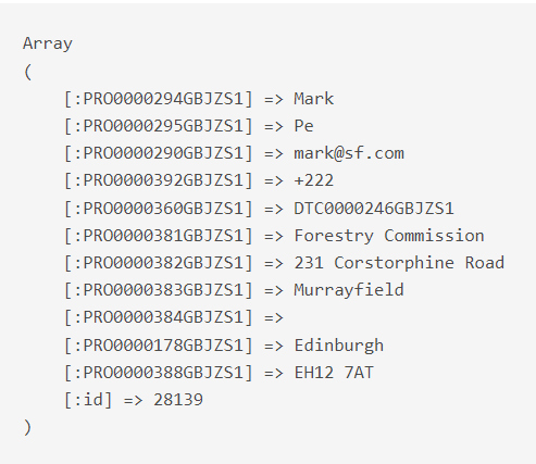

What does your “data_to_save” array look like?
This is the data_to_save array:
So, assuming is :PRO0000360GBJZS1 the field path to the your data type choice and the DTC0000246GBJZS1 is the correct data type choice value, that data should save.
Are you seeing anything in detective log when trying to save? can you look at the event that does the saving and see if the data type choice is being passed in?
:PRO0000360GBJZS1 is the field path for the data type choice, yes.

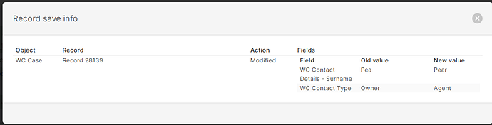

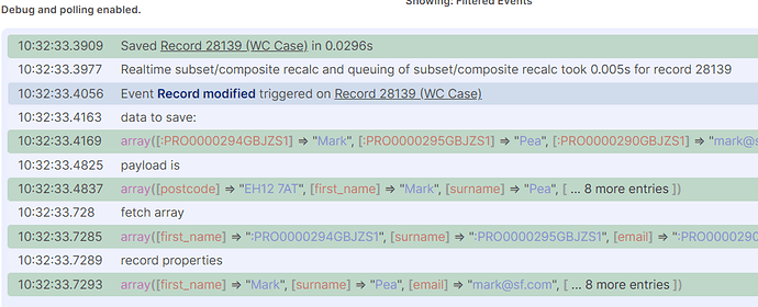

I’m not seeing any errors in the log. When I change a value and save, this is what detective shows:

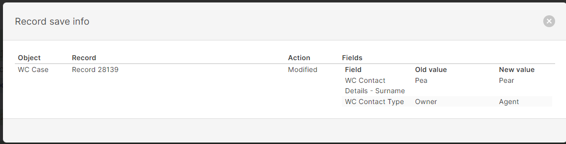

If you click yhe “Saved Record 28139…” link that should show a popup with all the values that are being saved, check if it is there.
Thanks (did not know that!). Looks like the new value is being saved:
Have you got something like the Object explorer ? check that record and all the properties to see if they are there, maybe it is being saved but there is an issue elsewhere?
