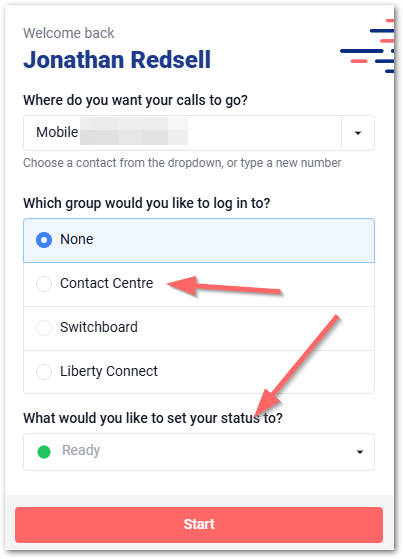

HI @evet HI Tony. In Liberty Converse, when the Agent logs in they will see at the bottom of the login page an option to select a busy code.
In this image of Liberty Converse 5.15.1 you can see that I can select the Contact Centre I want to log into (if you have more than 1) and then I can select the Busy Code before pressing start to log in.

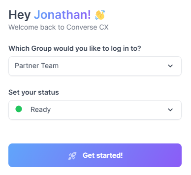

We have the same feature in Liberty Converse CX as well.
If you are not seeing this option, can you advise of the version of Liberty you are using and if there is a screenshot of what the Agent sees once they have logged in with their credentials.

I believe ours is an older version as we do not have the dropdown for status as shown in your screenshot, but it is good to know when we update it will become a feature we can use.
